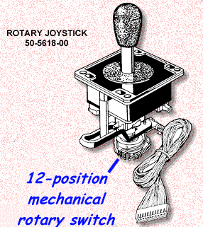

Happs 12-position Rotary Switch Joystick The Happs Rotary specs:Exploded mounting view.
- 12-position rotary switch ("Ikari warrior type")
- 8-way microswitch (Joystick directions up/down/etc)
- Bat shaped handle
Messages in the 9/10/99 message archive about rotary joysticks: 197, 199, 246, 247, a huge thread starting with 928, and 973.
Comments on the rotary switch interface
Happ Controls puts both the 12-position rotary switch joystick (50-5618-00) and optical rotary joystick (50-5619-00) under one category. They are, in fact, two separate products. This makes discussions on the joysticks a bit confusing. They accomplish similar goals - not only being able to move the joystick up/down, left/right, but also to be able to twist/rotate the joystick for games that require it (such as Ikari Warrior). The rotary switch accomplishes this via a 12 position rotary switch mounted underneath the regular joystick controls. The optical accomplishes this via an optical interface. Compare the two figures below.
Several folks have reported great success interfacing the rotary switch joysticks to Druin's SNK LS-30 Rotary Joystick to MAME Interface.

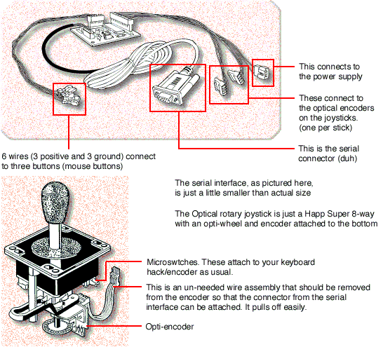

Happs Optical Rotary Joystick The Happs Optical Rotary specs:Exploded mounting view.
- Optical rotary interface
- Bat shaped handle
Comments on the optical interface
Happ Controls puts both the 12-position rotary switch joystick (50-5618-00) and optical rotary joystick (50-5619-00) under one category. They are, in fact, two separate products. This makes discussions on the joysticks a bit confusing. They accomplish similar goals - not only being able to move the joystick up/down, left/right, but also to be able to twist/rotate the joystick for games that require it (such as Ikari Warrior). The rotary switch accomplishes this via a 12 position rotary switch mounted underneath the regular joystick controls. The optical accomplishes this via an optical interface. Compare the two figures in the section above.
Torgo: The folks at Happ have assured me that their optical rotating joysticks can be connected to a pc using the trackball interface kit (either the serial or USB version). After speaking with Happ tech support some more and with information gleaned from other folks, you only need one serial (not USB) trackball interface for two rotary joysticks. Contrary to initial reports from Happ, you do not need to splice any wires together. The serial interface comes with everything you need, ready to go (except the power supply which they also told me I would not need, but, in fact, you absolutely do). You don't need to know anything about what each wire/pin does, as you just hook everything together with the wire harness that comes with plastic connectors pre-connected to the ends of all the wires. The picture below makes it crystal clear:
It is extremely easy to set up, and only takes about 15-20 seconds to make all the necessary connections - the whole thing is plug-and-play. In conjunction with Optimame, This setup is incredibly cool. Two player, authentically controlled Heavy Barrel, in my home absolutely rocks!
