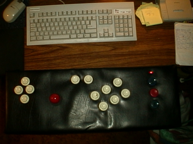

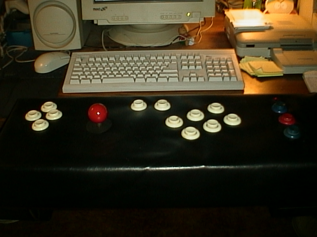

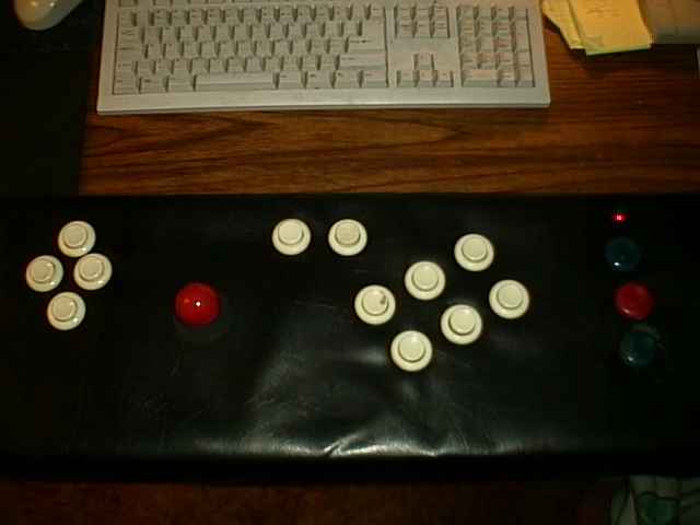

 Jerky2 used the Microsoft SideWinder
as his joypad to gut.  The advantage of this is that there are unused
solder points to connect to, and they are apparently labelled, making it
an easy joypad to hack.  Pictures of Jerky's project can be found
here,
here
and here :)

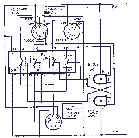

Keyboard Port - Hacking a keyboard
 The most hard core folks seem to be going with the keyboard port for interfacing
their controls to. This allows the highest number of inputs (more than
100 controls possible). This is the route I've taken.  To maintain
use of your computer with a keyboard hack, use a keyboard
splitter of some kind.
