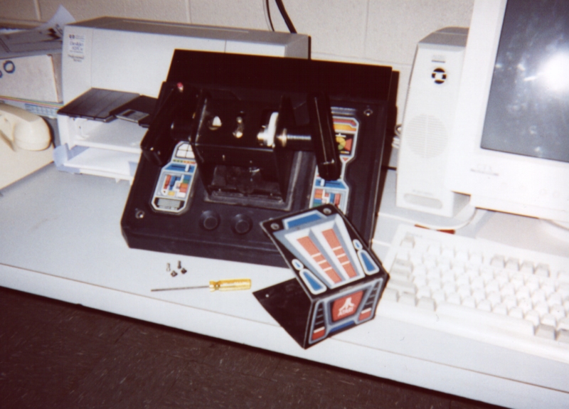

Episode I: GETTING THE DARN THING OPEN
"I already tried, it's magnetically sealed!"

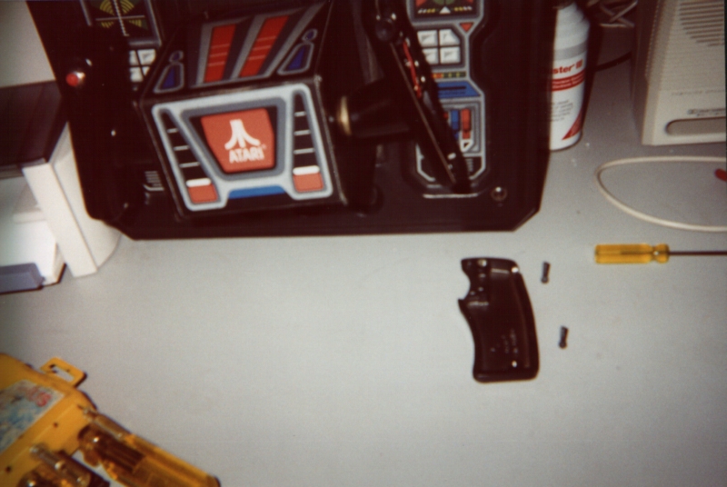

Before starting work on the flight yoke conversion, you need to gain access to the inner workings of the controller.  This means you have to take off the front face plate (the part that says Atari on it).  This plate is held in place with 4 pesky security type Allen head screws.  The ones on my controller were 3/32 inch hex, which means you need a 3/32 inch ball driver or Allen wrench to get them off.  If you can find a set of the security Allen wrenches, more power to you.  I received only strange looks at the local hardware stores, so I had to take more drastic measures.  If you find yourself in the same situation, you'll have to drill the little posts out of the bolts before unscrewing them.  Use a power drill for this (or a milling machine if you have access to one).  Be careful while drilling, or you'll wear down the edges and won't be able to get the screws out.  (I ended up replacing my screws with standard machine screws--if you want to do the same thing, buy screws with a 6 - 32 thread.) Once you have the screws off, you're ready to swap in some components.

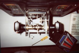

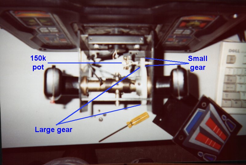

There are two pots in the controller, one that drives the vertical axis (inside the front panel you removed in Episode 1) and one that drives the horizontal axis (on the back side of the control panel).  The first thing you'll want to do is remove the plastic gears that are attached to the potentiometers.  This job requires a 7/64 inch ball driver (or Allen wrench).  Loosen the bolt, and slide the gear off the shaft.  Now you need to remove the potentiometers from the mounts in the panel.  You'll need to use an adjustable wrench to take out the potentiometers--they are held in place by nuts that are coaxial with the shaft.  You can now clip the wires (3 per pot) and remove the pots.  Save the pots in case you ever want to convert the controller back to its original state or go the USB hack route (see the FAQ below).
Top view, yoke interior:
The big plastic gear drives the smaller gear above it, which is attached to a 3/4" turn , 100k Ohm potentiometer (Y axis).
(Click picture for labeled details)
Click for a larger view!
(Click for a larger view)
Now it's time to put those new pots in the controller.  For the one going inside the front panel, you'll probably have to cut the shaft so the thing will fit inside (if you're using the same pots I bought).  Just put the shaft end in a vice and cut it to length with a hacksaw or dremel tool.   After cutting the shaft, place the pot in the same position as the original pot.  Replace the nuts and washers to insure a snug fit.  Do the same for the X axis pot.
What you need to do now is make sure the pots are centered.  If you have access to a multi meter, set it to measure resistance (Ohms) and dial each of your potentiometers until the meter reads 50 K Ohms.  Once the potentiometers are centered, replace the gears, insuring that the teeth of the small gears are interlocked with the teeth of the big gears.  Now, without turning the shafts of the potentiometers, tighten up the bolts on the shafts attached to each of the small plastic gears.  Once you have tightened the gears, check the resistance of the potentiometers.  They should read roughly 50 K Ohms while the mechanical axis in question is at its spring-centered point.  If you’re not reading 50 K Ohms, loosen the gear in question and repeat the procedure outlined above until 50 K Ohms is reached.  Make sure each axis is set so the controller is limiting the range of motion (by those heavy metal stops and posts) on the far left/far right (or far up/far down) positions.  If the pot the limiting factor in the motion, you won't be getting full motion onscreen during game play (and you might break the pot if you torque the controller too hard!).  You may need to revisit this process later for fine adjustment.  Now that everything is in place, it's time to do some wiring and soldering!

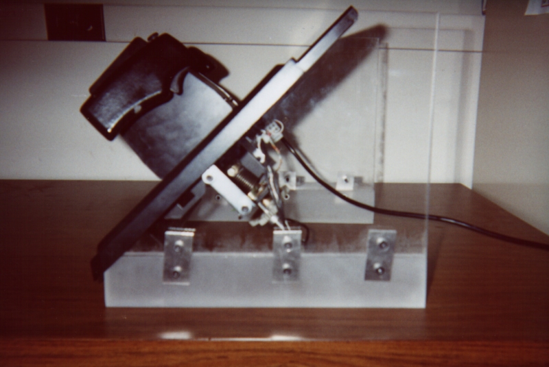

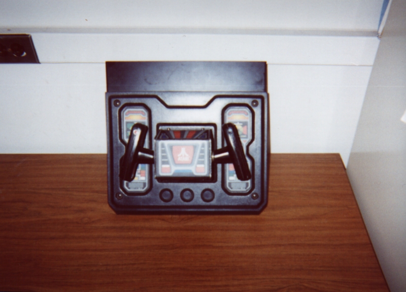

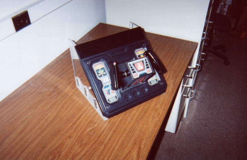

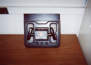

Epilogue:
"No more training do you require.. already know you, that what you need.."

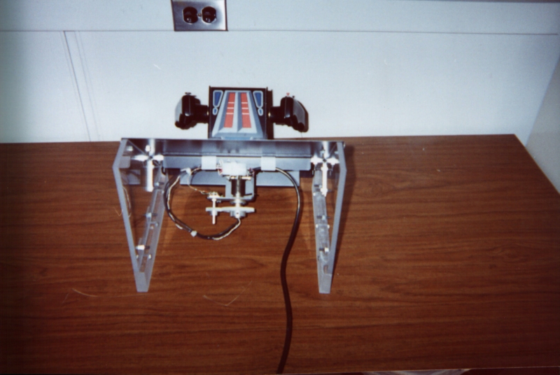

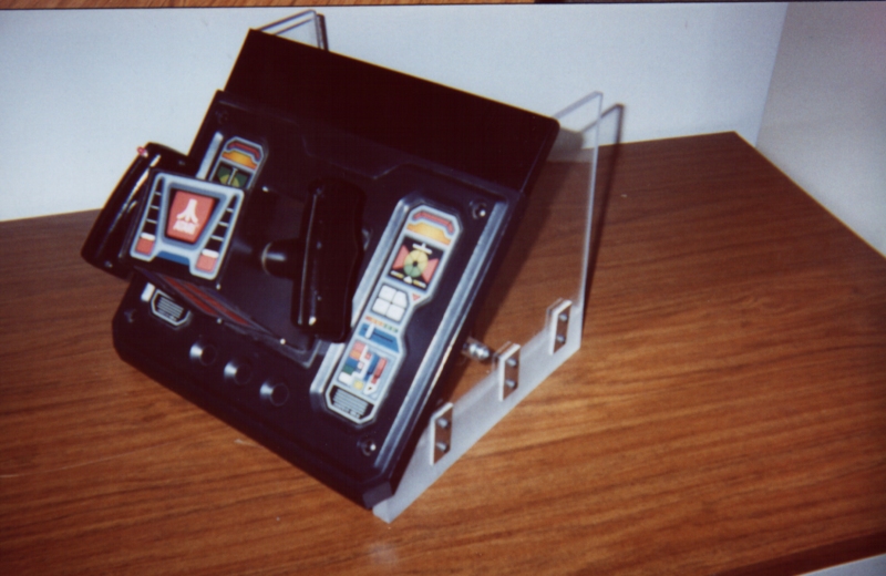

Now that you have finished the wiring, you still need to mount the control panel to something.  If you have an old neglected cabinet handy, go for it!  If not, you can fashion a case for the controller yourself.  I ended up making a desktop case out of plexiglass.  The plastic piece on the front of the control panel easily unbolts, giving you access to the bare sheet metal below.  This allows you to mount the control panel in any fashion you see fit.  I could go into some more details about the case I built, but I'll leave that story for another day!  If you have any comments, questions, or suggestions, feel free to contact me via email.
