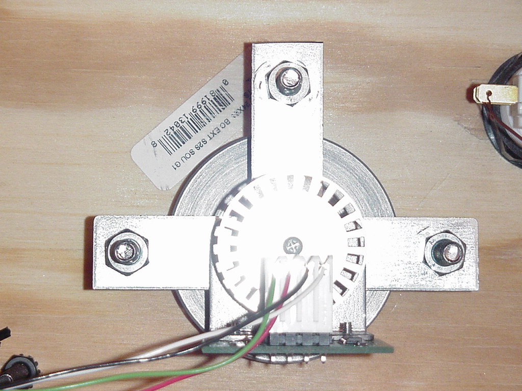

I had been letting the physical installation of the Fultra spinner intimidate me.  That was silly - it was really not difficult at all, and I have poor to non-existant woodworking skills.
I did have to make two attempts at the installation however, and that's because I ignored their installation advice.  In the documentation, they recommend the use of dowel centers to help align the holes you have to drill.  DO IT - I didn't and sure enough had the difficulties they suggested I might.

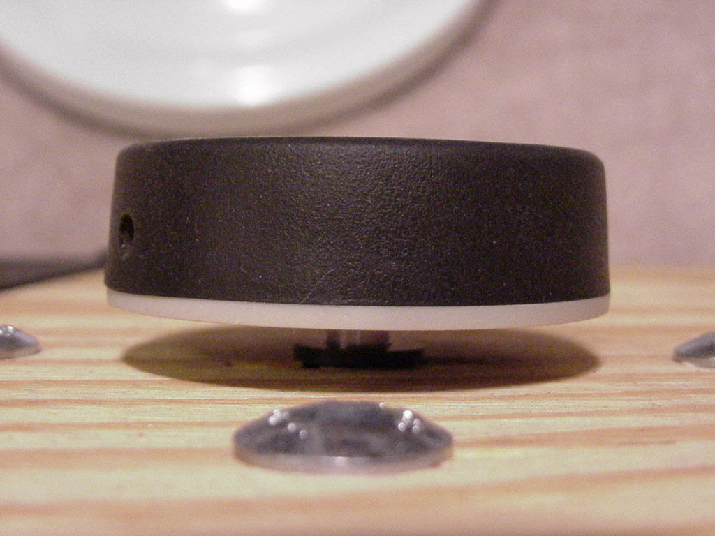

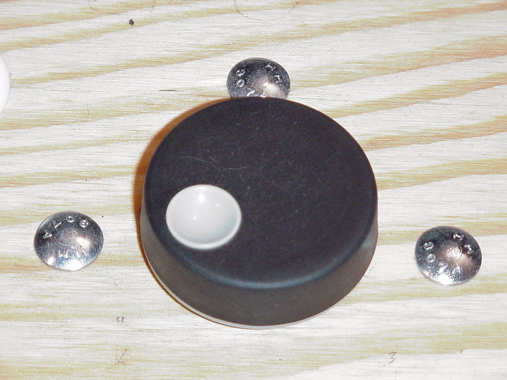

The Fultra spinner has a nice heft to it, and when mounted spins smoothly.  My spinner came with the black rubber knob, which had a good feel to it and was easy to grip and set spinning.  I think however the Tempest replica knobs Fultra is making would be a better choice though.  Several flicks of the knob averaged about 5 seconds each, with smooth motion across the screen.

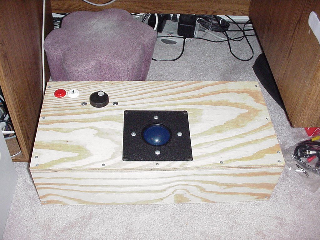

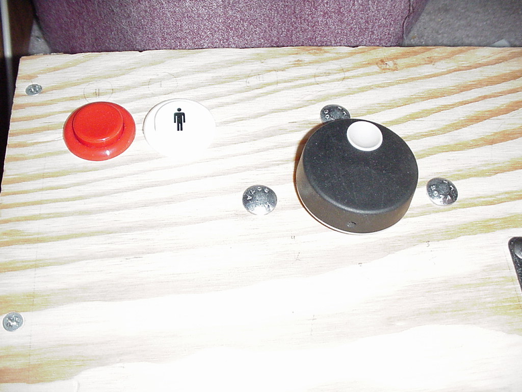

Here's a shot of the FrankenRig I use to test things.   Notice it fits quite nicely between the buttons and trackball.  The small profile means it will fit well in many different configurations.
