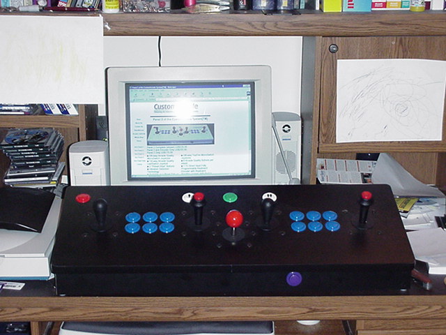

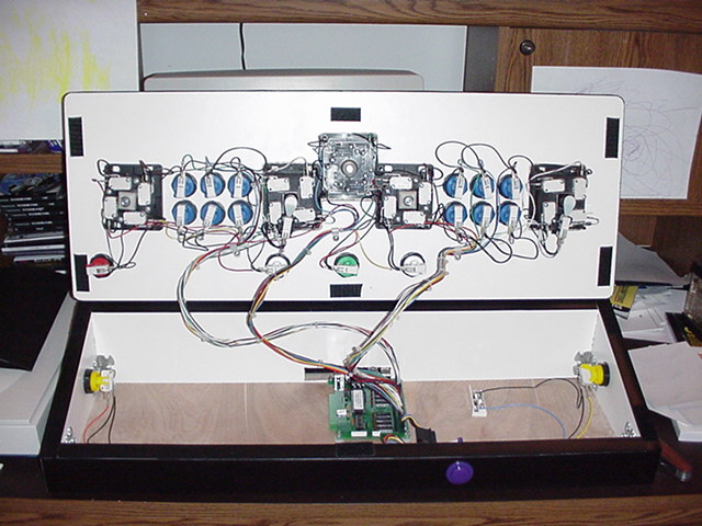

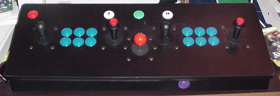

I have commented before on the size these various stand-alone consoles get to be...  This one is a sheer monster!  Measuring slightly over 30" by 11" and 6" high, it's constructed out of solid 3/4" wood, top quality Happ Controls joysticks and buttons, and a Wico red ball-top joystick (see note on this below) as well.  The top is removable via velcro strips used to mount the panel to the box.  At first, when I heard they were using velcro, I was dubious.  Then I attempted to remove the panel top... and tried ... and tried... and it absolutely would not budge until I put some force into it.  Not so much force that it's not openable, but enough force required that it won't budge during even vigorous gameplay.  The insides show a very neat and well done wiring job, making order out of what could easily have been a mass of spaghetti due to the number of inputs on this console.
This console has gotten quite a workout over the past few days, surviving not only my attempts to push it physically to it's limits but also two player gameplay with my exuberant brother, and slightly less co-ordinated but no less physical playing of my three year old daughter.  It took all the pounding we could give it and passed with flying colors.  High praise for the construction.

Outside view of the CustomArcade.  The consoles are getting bigger, my desk is getting messier!  For perspective, that's a 17" monitor it's dwarfing. Inside the CustomArcade.  Notice how neat it is despite all the wires involved.

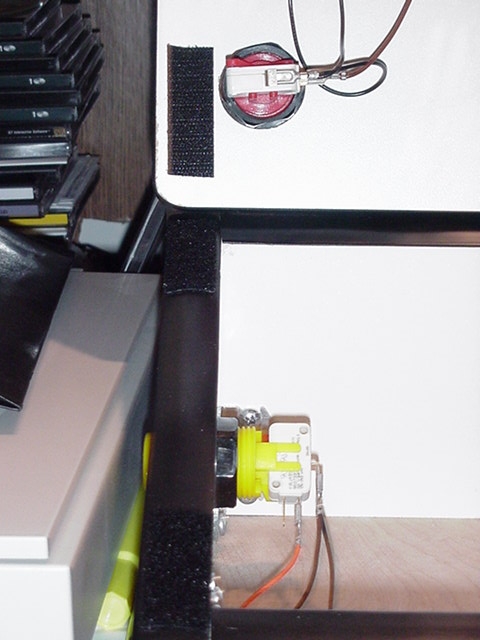

A shot of the velcro strips.  Quoteth Ray, "If it's good enough for NASA, it's good enough for me!" -- It certainly did the trick here!  Absolutely no problems with the way the console held together even during gameplay.

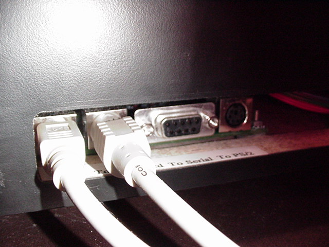

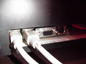

Setting up the CustomArcade was a snap.  Using the KE72T encoder from Hagstrom, there were just two cables to attach - a cable from the back of the console to my PC's keyboard port, and the keyboard's cable into the console.  I did not plug a serial cable into the encoder, choosing instead to program the encoder when needed via the keyboard port (See considerations below).  I also did not plug a cable from the back of the console to the PS/2 mouse port, which will be necessary should I obtain the trackball or spinner panel (again see considerations below).
(Click for a larger view!)
The back of the console with the two cables plugged in.
After the two minutes required to plug in the cables, I loaded up MAME and was off and running!

Another thing to bear in mind -- When I got my CustomArcade, I opened it up and tinkered with the insides.  When it came time to re-attach the cables, I wasn't sure what went where.  An email to CustomArcade supplied me cheerfully with the answer.  Also, the right hand top-fire joystick was not producing any keystrokes, until another email from CustomArcade pointed out to me that this was just how the system came pre-programmed, and when I set it up for the "mirrored" position it worked fine ...  None of this a problem, just what happens when you have so many programming possibilities from a flexible system like this.  HOWEVER - it wasn't until I began to poke around in the other materials that came with the CustomArcade that I found the HTML documentation, complete with excellent pictures and descriptions of all of the above.  Had I read them, I would not have had to email CustomArcade.  Excellent documentation, and with a system with as many options as the CustomArcade, you really should RTFM (F=full)!
